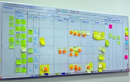

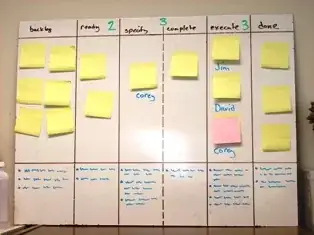

There is nothing in kanban that has a parallel with the oft seen applications of agile that attempt to minimize design time (note, there's nothing in the principles behind the Agile Manifesto that suggests no design either though it may be a reaction to the "Welcome changing requirements, even late in development" or "Working software is the primary measure of progress" being interpreted as "design is worthless" - but I doubt any of the signatories of the Manifesto would make that claim). When one looks at various demos of kanban boards one sees things like:
That first image has a 'specify' column. The second one shows an 'Analysis' and 'Design' column.
