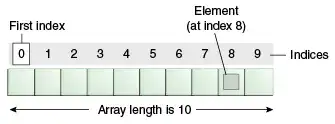

Because the index n of an array points to the n+1th element in the array (using zero-based indexing). Some simple math allows you to calculate the exact position of the desired element in O(1).
Further Reading
Java Arrays

  • did you create that diagram in the 8 minutes since the question was posted? If you did, what did you use to draw it? – gbulmer Aug 06 '14 at 00:01
  • I grabbed it from Google image search. Can't seem to find it now. – Robert Harvey Aug 06 '14 at 00:03
    Ah, here it is. http://docs.oracle.com/javase/tutorial/java/nutsandbolts/arrays.html – Robert Harvey Aug 06 '14 at 00:05
  • oh, well. I thought you were about to point me at an interesting drawing package. I would use omnigraffle to produce that, but it'd take me more than 6 minutes to do the drawing write that answer, fix my spelling, and post. With that picture, it is a good answer. – gbulmer Aug 06 '14 at 00:06
    @gbulmer for quick 'images' on stack exchange, you may find http://asciiflow.com to be useful. Sure, its not actually an image, but drawing ascii art quickly can be useful (especially if you need to fix something afterwards). –  Aug 06 '14 at 00:29
    Are you sure it's "n+1" elements away from the first element? More like n-1 or n depending on exactly what you mean. – Scott Whitlock Aug 06 '14 at 01:13
  • @ScottWhitlock: It's the n+1 th element from the top of the array. I'll edit to clarify. – Robert Harvey Aug 06 '14 at 03:26

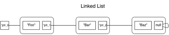

Contrast this to a singly linked list where we have a defined beginning of the list and then we add on to that list by having a pointer or reference address point to the next node in the list. Each node contains two things, a pointer to the next node in the list and a data item. Since you can't go back, each time you want an item from the list, even if you know exactly where it is, you need to traverse the whole list up to that item. Thus, we wind up with O(n/2) for average case access and O(n) for worst case. We can mitigate this some by doing a doubly linked list with a tail pointer as well as a head pointer but we still are limited to a form of sequential, rather than truly random, access. We set the last pointer to null to essentially tell the computer the same thing we are telling it when we give in the size of an array.
Linked_List

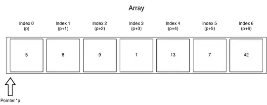

Simple answer:
Because you can calculate 453 + 6 in O(1) time too.
