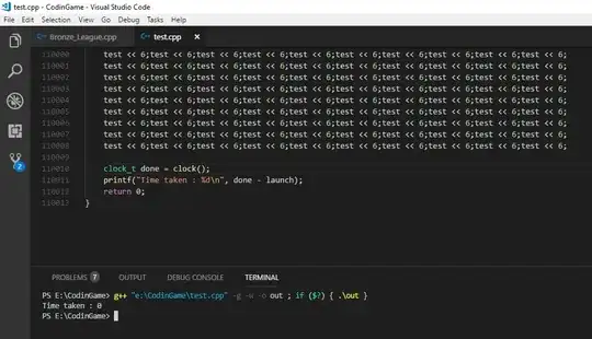

  • I get what you are saying, but I don't think the compiler is removing the entire loop. You can easily test out this theory by simply increasing the number of iterations. You will see that increasing the iterations does make the program take longer. If the loop was entirely removed this wouldn't be the case. – DollarAkshay May 02 '18 at 14:37
  • @AkshayLAradhya I can't say what your compiler is doing, but I confirmed again that gcc -O3 (now with 7.3) still removes the loop entirely. (Make sure to switch to a long instead of int if required, otherwise it optimizes it into an infinite loop due to overflow). – derobert May 02 '18 at 14:48

Your methodology is flawed. Your loop increment and condition checking itself is taking that much time.
  • Try running an empty loop and measure the time (call it base).
  • Now add 1 shift operation and measure the time (call it s1).
  • Next add 10 shift operations and measure the time (call it s2)
If everything is going correctly base-s2 should be 10 times more than base-s1. Otherwise something else is coming into play here.
Now I actually tried this myself and figured, If loops are causing a problem why not remove them entirely. So I went ahead and did this :
int main(){
    int test = 2;
    clock_t launch = clock();
    test << 6;
    test << 6;
    test << 6;
    test << 6;
    //.... 1 million times
    test << 6;
    clock_t done = clock();
    printf("Time taken : %d\n", done - launch);
    return 0;
And there you have your result
1 million shift operations in under 1 miliseconds ?.
I did the same thing for multiplication by 64 and got the same result. So probably the compiler is ignoring the operation completely as others mentioned the value of test is never changed.
Shiftwise Operator Result
