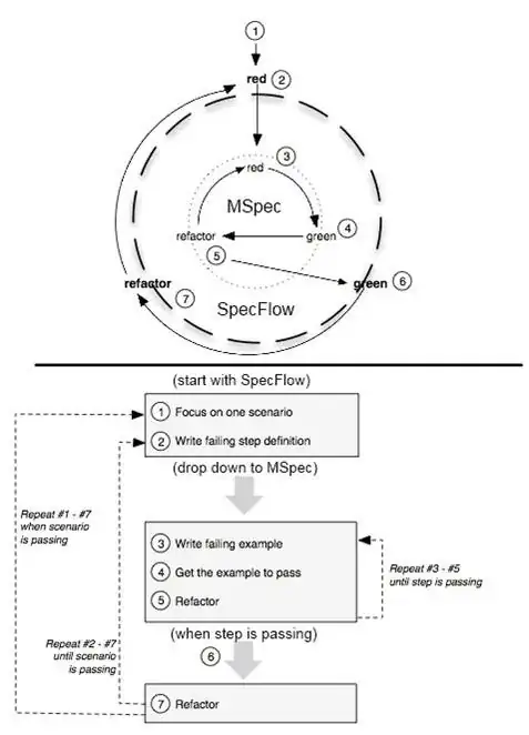

If you use these two types of tool together, you get a process like this:
BDD Cycle
Just picked from a random image search for "BDD Cycle". You can exchange SpecFlow with Cucumber, JBehave, TickSpec, or whatever. And you can replace MSpec with RSpec, or even traditional xUnit type frameworks.
