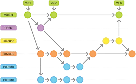

Git Flow
Git Flow
Git Flow defines a strict branching model designed around the project release. This provides a robust framework for managing larger projects. It defines specific branches for release, development, hot-fixes, etc. and the transitions between them.
There are a number of git extensions and tools available online to help support this workflow. Take a look at the nvie/gitflow extension for a starting point.
You can get a detailed explanation of the various stages and roles in the workflow here and here.
