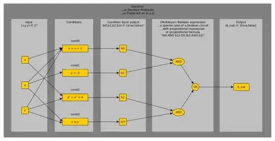

Suppose we have some software-under-test on which we want to do whitebox testing (i.e. we have the source code). The code naturally contains many of those decision predicates that we all know and love and that show up after strings like if, while, until etc.
An example of the decision predicate might be:
((x>y+z) AND (y<-3)) OR ((z²+x²<4) AND (z≤y))
An example of a decision predicate
This decision predicate accepts a triple (x,y,z) of integer values (say) and outputs a boolean, b_out.
The first-level functions which map (x,y,z) to {TRUE,FALSE} are called conditions (also atomic conditions) in the TTA syllabus.
Condition testing coverage
One attains "condition testing coverage" by running test cases until all the conditions found in the decision yielded at least once true and at least once false.
One can thus achieve condition testing coverage by running the following five test cases (for example):
Truth table achieving condition testing coverage
Each of the the b0, b1, b2, b3 shows up at least once with true and at least once with false. In some test cases, we do not care about a given value as it has no influence on the condition whose output we want to get right.
