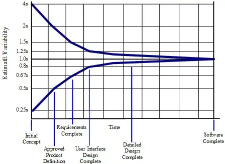

Consider the Cone of Uncertainty:
Image from http://www.construx.com - full article at http://www.construx.com/Thought_Leadership/Books/The_Cone_of_Uncertainty/
Realize that the first estimate in that range is 16x. This is akin to saying "I think it will take between an afternoon and two weeks" - but you don't know yet. As you go forward with the design a bit, the range narrows down to 4x. This does not mean that it will take one week, it means that you would instead be saying "after looking at this a bit, it will take between three weeks" - yes, the estimate went up, but also the range of the estimate went down.
With each estimate you give, you need to be 90% sure that the estimate is within that range. You can be wrong - 10% of the time it will fall out of that range.
