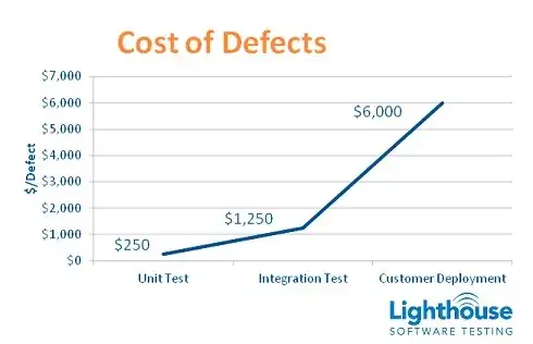

Testing software on your customers is by far the most expensive possible way to detect bugs, no matter what anyone says. It's a false economy; the free labor that you think you're getting is more than offset by customer service effort, breaking the software development life-cycle, and losing customer confidence.

    Robert, I have seen this diagram lots of times before. It was probably correct when software development followed a pure a waterfall model, but since software can be developed and deployed in small cycles, its got more and more wrong. To be precise - for a small amount of bugs and software the tendency is still true, for lots of bugs its definitely wrong. – Doc Brown Mar 12 '14 at 19:58
    @DocBrown: The graph is still correct. Shorter development cycles mean less cost per cycle, which is consistent with the graph. But that still doesn't mean you should alpha test your software on your customers, unless there is a clear understanding and agreement that this is part of the process. – Robert Harvey Mar 12 '14 at 20:00
  • Well, the cost of defects decreases the earlier the bug is found and fixed. And the chance a bug is found increases dramatically the earlier you get your software out of the door. That does not mean one should push untested software into production, of course. I recommend, for example, this article http://agileelements.wordpress.com/2008/04/22/cost-of-software-defects/ – Doc Brown Mar 12 '14 at 20:06

  • @DocBrown: I'm not sure if that article is describing an epiphany the author had, or merely stating the obvious. The X axis is time; the three points illustrated on that graph are just that: points. – Robert Harvey Mar 12 '14 at 20:12
  • Found also this one: https://www.techwell.com/2013/10/what-does-it-really-cost-fix-software-defect , might interest you. – Doc Brown Mar 12 '14 at 20:12
  • @DocBrown: That article is merely saying that the numbers might only be illustrative, may vary from project to project, and not be accurate to the dollar. That's also self-evident. – Robert Harvey Mar 12 '14 at 20:13
  • I was more referring to "So when we hear that defects are more expensive to fix the later they’re found, we don’t question whether that is actually true because we already believe it." – Doc Brown Mar 12 '14 at 20:14
    All it takes is a little self-reflection to see that the principle itself is sound, even if the numbers or the shape of the curve are just wild-ass guesses. We even have a name for it in programming parlance: Fail Fast. – Robert Harvey Mar 12 '14 at 20:15
