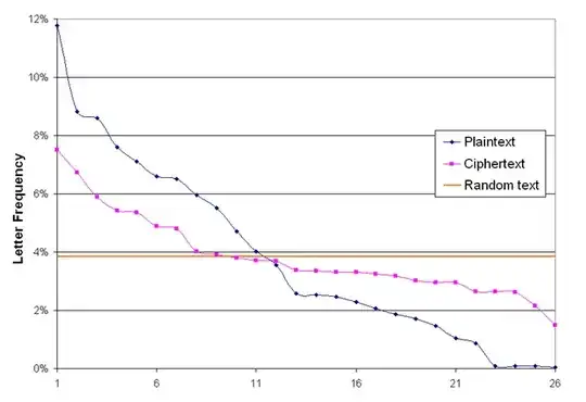

You can see this with (a simple cipher) the Vigenère cipher
http://en.wikipedia.org/wiki/File:Vigenere_letter_frequencies.PNG
(from Wikipedia: Vigenere letter frequencies)
Here we can see that the letter frequencies are much closer to random than regular English text. This would make it harder for the Huffman encoding to create an optimal encoding for the text.
Modern encryption schemes do an even better job of mixing the information of the key and the pain text together and create a data stream that has extremely high information density, and thus very difficult to predict what character comes next.
