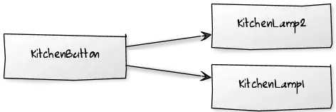

The name includes the term "inversion" because traditionally (y'know in the old dark ages of programming) you wrote software structures that had higher level modules depending on low level modules. E.g. it made sense to have a ButtonAtKitchen handling inputs for a KitchenLamp1 and KitchenLamp2. Unfortunately that made software a lot more specific than it needed to be and the object graph would look like this:
ButtonAtKitchen handles KitchenLamp1 and KitchenLamp2
So when you make the software more general, by adding "contracts". Notice how the arrows in the object graph "inverts" the direction. That kitchen lamps are now dependent on a Button. In other words the details are now dependent on abstractions instead of the other way around.

In the DIP example mentioned above, with the button and kitchen lamps, none of the kitchen lamps are extensible (nor currently has any requirement explaining they need to be). The design is breaking OCP but follows DIP.
A reverse (and a contrived) example would be a kitchen lamp be extensible (with the extension point being something like a LampShade) but the button is still dependent on the lamps. It is breaking DIP but follows OCP.
