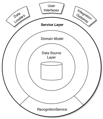

Having said all this, I think this is pretty close to what Martin Fowler meant by saying
These services live on top of the domain model and use the domain model for data.
Diagram below illustrates this pretty well:
http://martinfowler.com/eaaCatalog/serviceLayer.html
http://martinfowler.com/eaaCatalog/ServiceLayerSketch.gif
