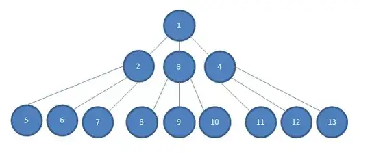

Given an object model as follows:
... Also consider that our application's dependency depth goes much deeper than I could fit in this image, so that there are multiple layers N between the 2-4 layer and the 5-13 layer.
If I want to test some simple logical decision being made in unit #1, and if every dependency is constructor-injected into the code module that depends on it such that, say, 2, 3, and 4 are constructor injected into module 1 in the image, I would much rather inject mocks of 2, 3, and 4 into 1.
Otherwise, I would need to construct concrete instances of 2, 3, and 4. This can be more difficult than just some extra typing. Often 2, 3, and 4 will have constructor requirements which can be challenging to satisfy and according to the graph (and according to the reality of our project), I'll need to construct concrete instances of N through 13 to satisfy the constructors of 2, 3, and 4.
This situation becomes more challenging when I need 2, 3, or 4 to behave in some certain way so that I can test the simple logical decision in #1. I might need to understand and "mentally reason about" the entire object graph/tree all at once to get 2, 3, or 4 to behave in the necessary way. It often seems much easier to do myMockOfModule2.Setup(x=> x.GoLeftOrRight()).Returns(new Right()); to test that module 1 responds as expected when module 2 tells it to go right.
If I were to test concrete instances of 2 ... N ... 13 all together, the test setups would be very large and mostly duplicated. Test failures might not do a very good job of pinpointing the locations of regressions failures. Tests would not be independent (another supporting link).
Granted, it is often reasonable to do state-based, rather than interaction-based, testing of the bottom layer, since those modules seldom have any further dependency. But it seems that mocking is almost necessary by definition to isolate any modules above the bottom-most.
Given all of this, can anyone tell me what I might be missing? Is our team overusing mocks? Or is there perhaps some assumption in typical unit testing guidance that the layers of dependency in most applications will be shallow enough that it is indeed reasonable to test all of the code modules integrated together (making our case "special")? Or perhaps differently, is our team not bounding our bounded contexts adequately?

  • I should have been clearer in the original post, to say that module 1 is only aware of I2, I3, and I4. Module 2 is only aware of I5, I6, and I7. It is only the questionable goal of testing without using mocks that I would provide a concrete 2, 3 and 4 to 1, leading to the challenges I described. Otherwise, we wind up using mocks far more than 5% of the time. – ardave Oct 15 '13 at 19:15
Not at first glance.
If you have 1..13 modules, then each should have its own unit tests, and all (non-trivial, untrusted) dependencies should be replaced by test versions. That can mean mocks, but some people are pedantic with naming, so fakes, shims, null objects... some people refer to all test implementations as "mocks". This might be the source of the confusion about how much is "right".
Personally, I just call all test objects "mocks" because distinguishing between the variety of them isn't often useful. As long as they keep my unit tests fast, isolated and resilient... I don't care what they're named.

  • I would wonder then if there is any general guidance out there for when it is best to test code modules in isolation vs. testing more than one code module, integrated together. It seems like as soon as I integrate any two modules which I could have otherwise isolated, I open myself up to a host of undesirable issues: Lack of pinpointing of regression causes / multiple tests failing for a single regression, excessive test setups, etc. I have my own intuitive sense ("listen to the tests") but this has left me at the 70-90% mock level. – ardave Oct 15 '13 at 22:42
    @nono - In my experience, you should test everything in isolation, for the reasons you mention. The only things you don't unit test in isolation are things you can't because they go against some file system or other external resource directly (something has to do that after all). – Telastyn Oct 16 '13 at 00:45
  • After chewing on this for a few days, yours seems like the best possible explanation: If one were to use the strict definition of "mock" as a type of test double used for retrospective interaction/behavior verification, as opposed a dummy test double or a test double which is configured in advance to simulate some certain behavior, then yes, I could see winding up at the 5% level. – ardave Oct 18 '13 at 00:54
