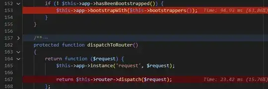

  • No-one seems to have mentioned that unit tests can test how long the operation takes. You can refactor your code with performance in mind, ensuring that the unit test tells you whether it passes or fails based on time as well as results. – CJ Dennis Oct 31 '17 at 02:08
