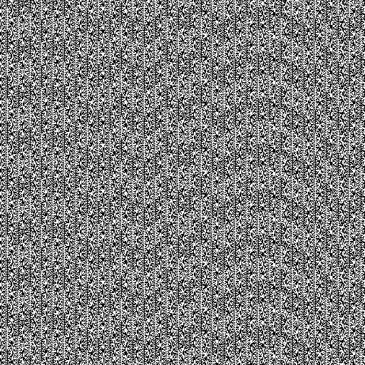

You can get an idea of the poor quality of rand in some generators from Random.org.
For, example, rand() called by php on Windows produces the following:
(from Random.org)
Which is quite certainly, not a good random.
