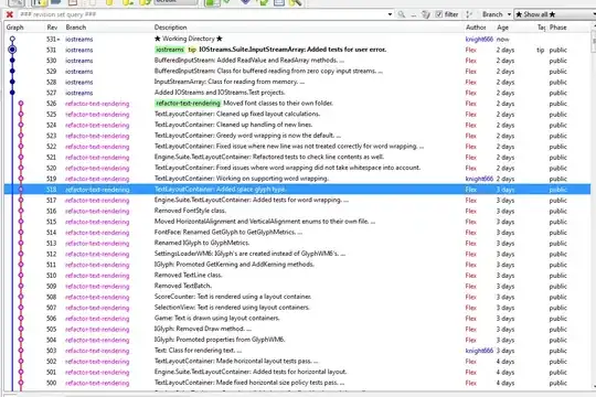

Here's what the repository for one my personal projects looks like:
Repository layout
I see a couple of advantages in this approach.
  • Small commits mean they are focused on a single subject. Every commit gets a one-line description of the changes, which makes them easy to follow even after weeks of inactivity.
  • Named branches keep you on topic. If you're working in the "refactor-text-rendering" branch, for example, you shouldn't make changes to the math library, because that's not related to the branch's topic.
However, the lead developer is annoyed by my methodology. He feels that the small commits clutter up the repository's history. His preferred methodology is to work in a patch. When the feature is done, he merges the commits and pushes them in one go.
So, what do you prefer? A flow of consciousness history of commits or a patch of changes every now and then? Or something else entirely?

Take your commit history, for your personal project as an example. There's 13 commit messages for 1 day (ie. the "2 days ago"). Now imagine what that history would look like for the same time period if 50-200+ developers worked on the project in the same manner. That's 650-2600 commit messages a day. The commit history for a week would intractable for a human.
So it depends on the team size: On small teams, it's good detailed information. As the team gets larger it quickly explodes into a mess of noise, making the history functionally useless.
