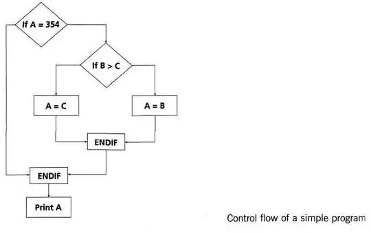

How to calculate Cyclomatic complexity "basically":
From example here: consider the following pseudo code :
if (A=354) {
    if (B>C) {/*decision 1*/ A=B} else {/*decision 2*/ A=C}
   }/*decision 3 , in case A is NOT equal 354*/
print A
please note that this metric is concerned about number of decision in your program/code so from the code above we could say that we have 3 decisions ( 3 values of A)
let's calculate it formally so consider the following control flow of the code: enter image description here
The complexity M is then defined* as:Ref
M = E − N + 2P
where
E = the number of edges of the graph
N = the number of nodes of the graph
P = the number of connected components (exit nodes).
by applying the formula E(flow lines) = 8 , N (nodes)= 7 , P (exit nodes) =1 then M = 8-7 + (2*1) = 3
*there is also another definition stated but it is close :M = E − N + P check the reference for theory.
Please note that many of static code analysis tools could calculate the Cyclomatic complexity of your code.
