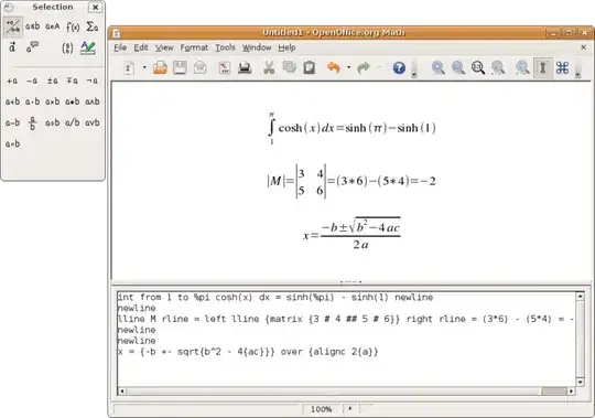

You are right. Since you already are looking for a way to do it outside code, and Tex is an overkill besides having a steep learning curve, my recommendation is as follows:
Use OpenOffice.org/LibreOffice Math Equation Editor.
It's free. It's open.
You can use it either visually or you can write the equations in a special language.
You don't have to learn the language right away because when you use the GUI, the "code" is generated in a panel for you to see.
In the upper panel you can "draw" the equations using a pallete. In the lower panel the equivalent notation is generated. You can do it the other way around once you've got a grasp of the notation, writing in notation in the lower panel and seeing the graphical output in the top panel.
  • Then what? Include the plain-text code for the math notation in the original code as comments, or take a screenshot and use Javadoc like the OP said he might do with TeX? – dodgethesteamroller Jun 28 '13 at 17:19
  • @dodgethesteamroller Yes, my answer says "Since you already are looking for a way to do it outside code, and Tex is an overkill.." – Tulains Córdova Jun 28 '13 at 18:02
