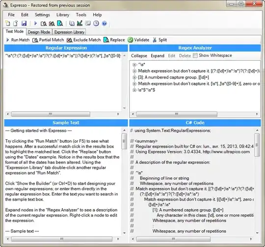

I like to use Expresso: http://www.ultrapico.com/Expresso.htm
This free application has the following features that I find useful over time:
  • You can simply copy and paste your regex and the application will parse it for you
  • Once your regex is written, you can test it directly from the application (the application will give you the list of captures, replacements...)
  • Once you have tested it, it will generate the C# code to implement it (note that the code will contain the explanations about your regex).
For example, with the regex you just submitted, it would would look like: Sample screen with the initially given regex
Of course, giving it a try is worth a thousand word describing it. Please also note that I'm note related in any way with the editor of this application.
