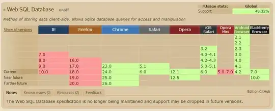

It is my understanding that the SQL storage capabilities of HTML5 aren't fully implemented (IE and Firefox apparently don't support yet per one site I read.) LocalStorage may not be robust enough for the data we need to sync since the size limit is relatively small.

    I found this chart. It's kind of handy! http://caniuse.com/sql-storage – Darkwater23 Feb 15 '13 at 19:50

Check out caniuse.com. For WebSQL, it's deprecated:

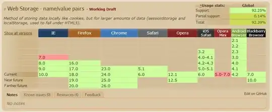

However, if key-value stores are an option that might do:

    To be fair, all that chart says is that Microsoft and Mozilla never implemented WebSQL. Wikipedia says that the working group stopped working on the specification because nobody bothered to come up with implementations that competed with SQLite. IndexedDB does a bit better than WebSQL, if you don't mind it being buggy on a Mac. – Robert Harvey Feb 24 '16 at 16:04
