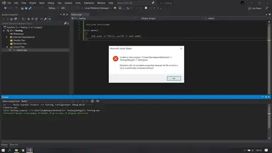

For all we know.. this is happening at this very moment:
It's hard to know for sure...
