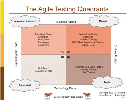

This might help you:
The agile testing quadrants
Q1 are written by the developers.
Q2 are automated by the developers and written in collaboration with the business and/or testers.
