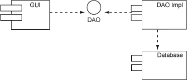

What problems will I face if I remove the concept of interfaces from my code?
What you will get is the tight coupling of your system. As the saying goes "In pursuit of code quality: Beware the tight couple!"
What is tight coupled software system?
You probably have at least heard the term coupling used in the context of object-oriented programming. Coupling refers to the interrelationship(s) of components (or objects) in an application. A loosely coupled application is more modularized than a tightly coupled one. Its components rely on interfaces and abstract classes as opposed to concrete ones, as they would in a tightly coupled system. In a loosely coupled system, components are interrelated using abstractions instead of implementations.
A common schema of tightly coupled software system (GUI and DB without abstraction layer in between)
The GUI's dependence on an implementation rather than an abstraction limits the system. You cannot operate the GUI without having the database up and running. This design doesn't seem so bad from a functional standpoint -- we've been writing apps like this for years and planes aren't falling out of the sky, after all -- but testing it is another story.
OK, how to tight coupling? - will Interfaces do the trick? - Turn the coupling to be loose!
The GUI in above software system relies on an abstraction - a data access object or DAO. The DAO's implementation is directly dependent on the database, but the GUI itself is not entangled. Adding an abstraction in the form of a DAO decouples the database implementation from the GUI implementation. In place of the database, an interface is now coupled to the GUI code.
In conclusion - One thing developers have come to agree on is that well-written code is maintainable, and the Dependency Inversion Principle is a sure way to design for maintainability. Dependency inversion stresses reliance on abstractions over implementations, which creates a great deal of flexibility within a code base. Applying this technique with the help of a DAO, ensures that not only will you be able to modify your code base when you need to, but so will other developers.
