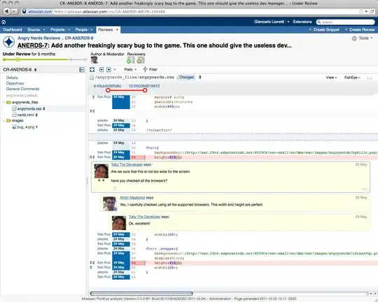

Atlassian Crucible showing a threaded discussion in a code review.
In the screenshot above, for instance, you can see a threaded discussion directly inlined with the code to highlight a concern, and this is being done as part of a formal core review item (with the ID CR-ANERDS-8) relating to an open ticket (with the ID ANERDS-7).

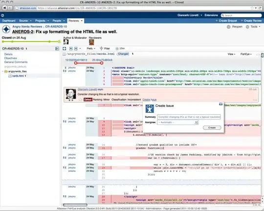

Atlassian Crucible used to open a nez JIRA ticket for a follow-up action after a review.
Here is an example of a use case where you create a new ticket to be able to track future follow-up actions on the review. The reviewer can easily create tasks as he sifts through your code and notices shady spots.
There are numerous tools for this, but personally I tend to find FishEye and Crucible above par (and obviously working great hand in hand with JIRA, or even Confluence to link to even more detailed docs if needed).
