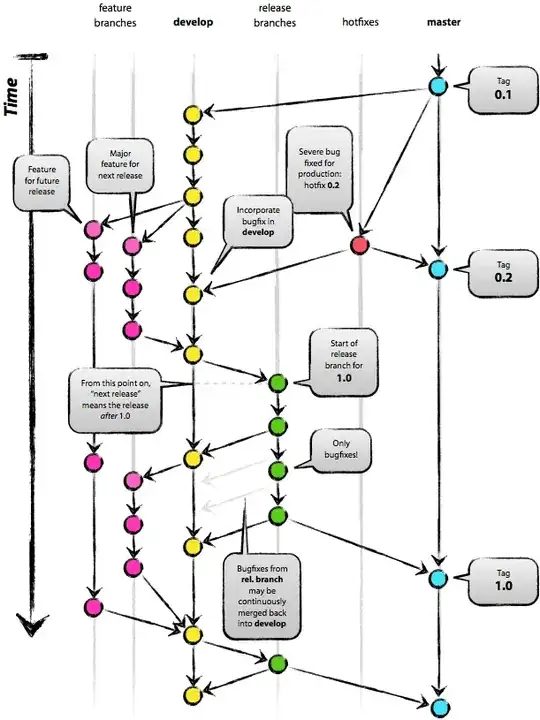

I have found many, many, useful blogs and posts to learn from. However, the ones that are professionally illustrated are rare ones. Thus, I would like to recommend a post - A successful Git branching model by @nvie. I have borrowed his illustration :)

    1.0-2-g1ab3183 is an identifier constructed by git describe from information available from git, but calling it a git identifier is a little too much. Git identifies by SHA hash; tags and branches are human constructs that git helpfully keeps track of. As such, make a tag when you think some human will one day wish to find a convenient bookmark to a commit. – mabraham Apr 21 '14 at 23:52
    a wonderful illustration of multi-dimensionality in the git universe. beautiful. thanks – Tope Jan 19 '19 at 06:08
    It is worth noting that many projects do not have a need for some of the lanes shown in this diagram. Some projects only need what's called develop and feature here. This is often true for web apps that can be deployed at will. – usr Sep 01 '19 at 11:51
    Even the author of git flow no longer recommends it for many project types, such as web development. Many people believe it is much more complex than the vast majority of projects need, making it troublesome to execute and easy to get wrong. At the other end of the spectrum, some advanced practitioners advocate teams use 'trunk based development', which almost never uses branches at all, and deliver successful projects like that. For something intermediate, consider "anti-gitflow' – Jonathan Hartley Oct 16 '20 at 03:38
  • Hi @JonathanHartley can you please provide a link to that reference about the Git Flow author depreciating Git Flow for some project types? Sounds like a good reference to support improvement in some organisations, or perhaps you were referring to: https://nvie.com/posts/a-successful-git-branching-model/ – NeilG Nov 17 '22 at 23:06
    @NeilG I suspect I was thinking of the link you provide, or one very like it, in which the author of git-flow says "If your team is doing continuous delivery of software, I would suggest to adopt a much simpler workflow (like GitHub flow) instead of [...] git-flow." – Jonathan Hartley Nov 18 '22 at 05:28
  • Hi @JonathanHartley, there were a lot of changes in the last 10 years. Thus, simplifying branching strategy for a web development is the way to go. – Yusubov Jan 26 '24 at 16:47
  • @Yusubov Hi! I don't think that's due to recent changes. Git-flow has always been very unsuitable for the vast majority of projects. It was created by an over enthusiastic theory of how branching ought to work, rather than by experience of what's actually useful. – Jonathan Hartley Jan 27 '24 at 14:12
