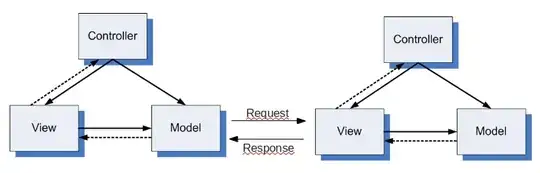

The one model, that helps me most, is nevertheless based on MVC. MVC on server side, and on client side. The view on the server is the model in the client application, so to speak. An illustration:
MVC on client and server
Your application seems to follow this principle roughly. You probably had a hard time to come up with a good structure in your HTML and JS. Try to look at it with this approach. Your client Model is the server side view, your JSON data. Your event bindings and stuff is your Controller. The HTML is your View. Try to separate events and UI logic from data interchange, and you will find a very powerful way of creating web applications.
