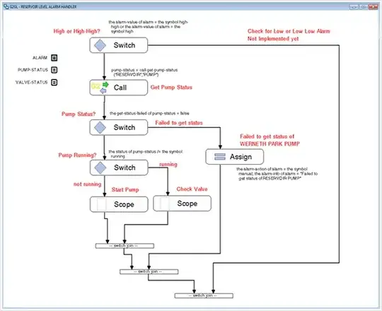

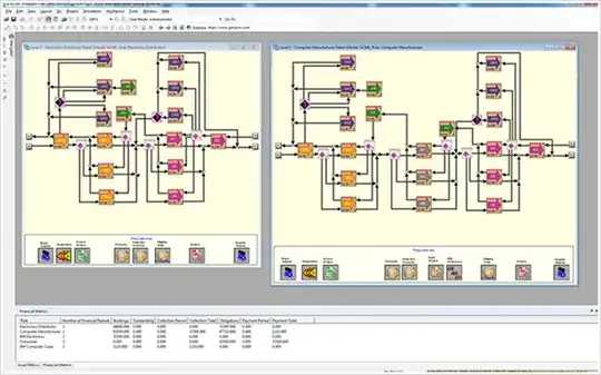

Addendum: Managing Visual Programming Environments
The Walled Gardens of Bespoke Programming Systems
Multiple programming systems, like the OP's G2, are different beasts...
No Source "Code"
Often they do not give you access to a textual representation of
your source "code": it might be stored in a proprietary binary
format, or maybe it does store things in text format but hides
them away from you. Bespoke graphical programming systems are
actually not uncommon in research labs, as they simplify the
automation of repetitive data processing workflows.

Personal Anecdote 2: Actually, I worked on one of these
myself. I didn't do the link with the OP's request, but my the
project was a set of inter-connected large pieces of
data-processing and data-storage software (primarily for
bio-informatics research, healthcare and cosmetics, but also for
business intelligence, or any domain implying the tracking of
large volumes of research data of any kind and the preparation of
data-processing workflows and ETLs). One of these applications was,
quite simply, a visual IDE that used the usual bells and whistles:
drag and drop interfaces, versioned project workspaces (using text
and XML files for metadata storage), lots of pluggable drivers to
heterogeneous datasources, and a visual canvas to design pipelines
to process data from N datasources and in the end generate M
transformed outputs, and possible shiny visualizations and complex
(and interactive) online reports. Your typical bespoke visual
programming system, suffering from a bit of NIH syndrome under the
pretense of designing a system adapted to the users' needs.
And, as you would expect, it's a nice system, quite flexible for its
needs though sometimes a bit over-the-top so that you wonder "why
not use command-line tools instead?", and unfortunately always
leading in medium-sized teams working on large projects to a lot of
different people using it with different "best" practices.
