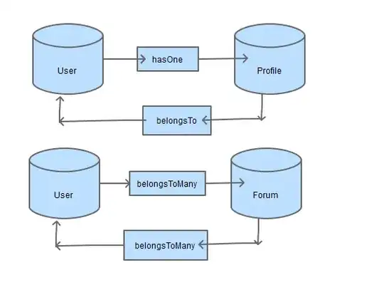

Laravel Relationship at a glance: Try to understanding to figure and text:
  1. One to one(hasOne) relationship: A user has(can have) one profile. So,A profile belongs to one user.
  2. One to many(hasMany): A user has many(can have many) article. So, Many article belongs to one user;
  3. Many to many(BelongsToMany): A User can belongs to many forum. So, A forum belongs to many user.
In graphical view enter image description here
