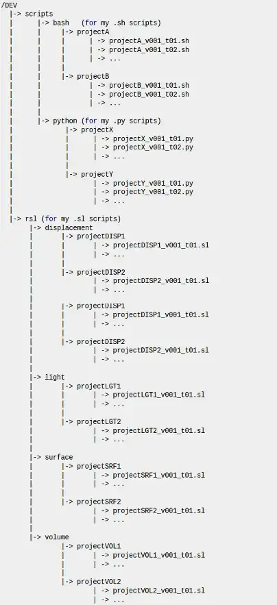

I am trying to set-up a simple SVN workflow at home. I am new to subversion (and programming) so I have been reading the official PDF documentations but still not sure about how to set-up my repository.
I am working mainly with python, bash and rsl (Renderman Shading Language)
So I already have a /dev structure on my disk as this:
/dev structure

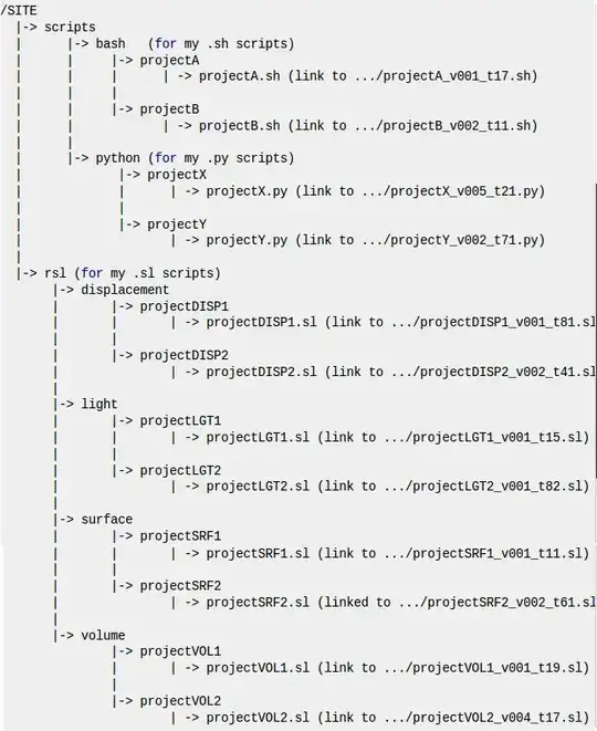

And I have a /site structure that links to my /dev folder:
So obviously starting to use SVN will change this approach that I already have in place.
The question is when I am setting-up my SVN repository for the work I do in my /dev folder:
Will I set-up a separate repository for each different programming platform? and Where exactly I should be placing my repository?
Thanks.

    I don't quite understand the structure you are referring to. Can you make a short description, maybe trimmed down to three or four files, and including what the relation between dev/ and site/ is in the file system. (Better do not write /dev, since that is a standard place on unixoid systems for something else.) – Christopher Creutzig Apr 10 '12 at 17:21

Ignoring all biases towards one or another VCS, the layout of your dev directories should conform to what works best for you while working. Then you map the version control to that.
One (lazy) pattern is just to host the VCS at the top level (/dev) and let everything be part of one big repo. I don't like this, and it's probably a bad idea anyway. Ties too much stuff together (and yay, this is how my office uses TFS).
A better idea is to split along either project lines or conceptual lines. A conceptual split in your case would be to put all the bash projects into one repo. Another similar idea is to put all projects related to one larger goal into a repo together. A project split would be to put each individual project as its own repo. I like the project split best myself, as I think this gives you the most granularity in maintaining the repo, and it keeps the history clean by only showing one project. Obviously some VCS will favor different splits, and offer varying support for them.
In SVN in particular, it is very common to have something like:
/ProjectX (RepoRoot)
|--/trunk
|  |--/ProjectX
|--/branch
|  |--/ProjectX_401changes
|  |--/ProjectX_refactoring
|  |--/ProjectX_failedExperiment
|--/tag
|  |--/ProjectX_Release20120101
|  |--/ProjectX_Release20120411
Again, most VCS programs will have their own ideas about how that actually looks, but pretty much all of them offer something like this conceptual divide. They key is that not only is your code versioned through changes, but also release states. Code can be the main line of development (Trunk), an offshoot to add complex new features or to experiment (a Branch), or a known good state that you should be able to easily get back to (a Tag).
Generally you'd host the "central" repo on another machine, but you can also just use another folder on your computer (but preferably on a different harddrive at the very least). If you have multiple repos, then you'd probably roughly mirror your working pattern, but with the SVN structure above in each repo folder. Note that in reality, the remote repo is often called "bare" or something similar because it doesn't actually have a copy of the real files exposed, it just hides everything inside the .svn folder (or .git, .bzr, etc).
Finally, using any VCS means learning the tools. You can use a graphical tool if available, and they tend to make using VCS a lot more pleasant. However, the command line tools are usually quite easy and will help you understand what VCS is actually doing.
