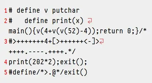

Polyglots
Polyglot code is valid and equivalent in more than one language. Stack Overflow's 404 page features one such program:
Stack Overflow 404 polyglot
This prints "404" in Python, Perl, Ruby, C, Brainfuck and Befunge.
Conclusion
Languages are rarely mixed within files, and when they are, it is for laughs. People even try to avoid mixing languages within projects because of the extra hassle it introduces. So, while it can be technically possible, mixing different languages is neither common nor pragmatic.
