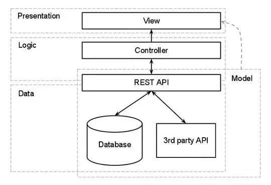

A rough diagram of the architecture of the latest large scale project I was involved in.
It's only a basic outline, adapted from the actual architecture documents and presented in a way that resembles a typical n-tier approach combined with a typical MVC approach. As you can see the logic and data tiers are connected via a service layer, and more specifically a REST API, that was inspired by Recess, a lesser known PHP framework.
