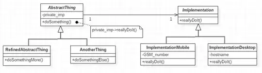

The bridge intends to decouple an abstraction from its concrete implementation, so that both can vary independently:
  • refine the abstraction with subclassing
  • provide different implementations, also by subclassing, without having to know neither the abstraction nor its refinements.
  • if needed, choose at runtime which is the most suitable implementation.
The bridge achieve this by using composition:
  • the abstraction refers (reference or pointer) to an implementation object
  • the abstraction and its refinements only known the implementation interface
Additional remarks on a frequent confusion
This pattern is very similar to the adapter pattern: the abstraction offers a different interface for an implementation and uses composition to do so. But:
The key difference between these patterns lies in their intents
- Gamma & al, in "Design patterns, element of reusable OO software", 1995
In this excellent seminal book on design patterns, the authors also observe that:
  • adapters are often used when an incompatibility is discovered and the coupling is unforeseen
  • bridges are used from the beginning of the design, when it is expected that the classes would evolve independently.
