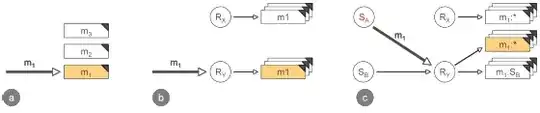

As many said any program, once compiled, is turned into a binary code and, as a binary string might be used to represent an integer, any program is eventually just a number. However defining the number you need could be pretty hard and that is why high level programming languages came up. Programming languages are just models of the assembly code they eventually produce. I would like to explain you the difference between procedural and OO programming by means of this very nice paper about Context Oriented Programming http://www.jot.fm/issues/issue_2008_03/article4/
as you can see from this picture, depicted in the paper, Procedural programming provides only one dimension to associate a computational unit with a name. Here, procedure calls or names are directly mapped to procedure implementations. In Figure-a calling m1 leaves no choice but the invocation of the only implementation of procedure m1.
Object-oriented programming adds another dimension for name resolution to that of procedural programming. In addition to the method or procedure name, message dispatch takes the message receiver into consideration when looking up a method. In Figure-b we see two implementations of method m1. The selection of the appropriate method not only depends on the the message name m1, but also the receiver of the actual message, here Ry.
This indeed allows encapsulation and modularization.
Figure-c is finally about subject-oriented programming extends object-oriented method dispatch by yet another dimension.
Hope this helped you thinking at OOP from a different perspective.
