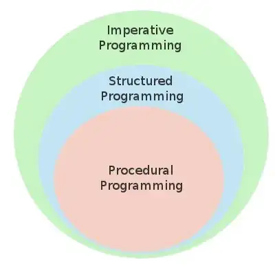

By researching around (books, Wikipedia, similar questions on SE, etc) I came to understand that Imperative programming is one of the major programming paradigms, where you describe a series of commands (or statements) for the computer to execute (so you pretty much order it to take specific actions, hence the name "imperative"). So far so good.
Procedural programming, on the other hand, is a specific type (or subset) of Imperative programming, where you use procedures (i.e., functions) to describe the commands the computer should perform.
First question: Is there an Imperative programming language which is not procedural? In other words, can you have Imperative programming without procedures?
Update: This first question seems to be answered. A language CAN be imperative without being procedural or structured. An example is pure Assembly language.
Then you also have Structured programming, which seems to be another type (or subset) of Imperative programming, which emerged to remove the reliance on the GOTO statement.
Second question: What is the difference between procedural and structured programming? Can you have one without the other, and vice-versa? Can we say procedural programming is a subset of structured programming, as in the image?

To be specific to your questions:
First Question : Pure assembly language is imperative language which is NOT structured or procedural. (Having step by step interpretive control flow doesn't mean procedural - but division of functionality into functions is what makes a language procedural).
  • correction * Most modern forms of assembly DO support the use of functions. In fact, everything that's possible in high level code HAS to exist low level to work. Although it's a far better practice to create procedural code, it's possible to write both procedural and imperative code. Unlike the latter, it's more maintainable and easier to understand (avoiding horrible spaghetti code). I think there are shell/bash scripts that better fit the accolade of being purely imperative, but even then, most have functions, developers definitely understand how much value they have.
Second Question : Procedural programming is a FORM of structured programming.

    So would you say that procedural programming necessarily is also structured programming, while the opposite is not true (though often the case)? – Daniel Scocco Oct 31 '11 at 18:33
    Yes, i would say so. – Dipan Mehta Nov 01 '11 at 03:10

First question: Yes, many pure object-oriented languages qualify. While they have methods, which are very close to functions, they view these methods in terms of messages and do not give them enough weight to call the language procedural.
Second question: The difference is often in a different scope. You can have a function with goto statements all over the place, which will be in procedural style, but not structured programming. On the other hand, most OO languages support and encouraged structured programming, but not procedural programming.
Procedural programming describes the global ordering of the program. Procedural programs are those that are most effectively understood by looking at their call graphs. Structural programming is a local property, it applies to the use of if and while as opposed to goto.
As such, these two properties are disjunct, you can have either one without the other.
