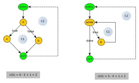

Let's illustrate by using McCabe' example from his paper:
McCabe's example
Here we have:
  • e = 10
  • v = 6
  • p = 1 (one component)
  • v(G) = 5 (we are clearly counting 5 cycles)
The formula for the cyclomatic number says:
v(G) = e - v + p
which yields 5 = 10 - 6 + 1 and so correct!
The "McCabe cyclomatic complexity number" as given in his paper is
5 = 9 - 6 + 2 (no further explanations are given in the paper as to how)
which happens to be correct (it yields v(G)) but for the wrong reasons, i.e. we use:
ṽ(G) = ẽ - v + 2
and thus ṽ(G) = v(G) ... phew!
But is this measure any good?
In two words: Not very
  • It is not entirely clear how to establish the "instruction flow graph" of a procedure, especially if exception handling and recursion enter the picture. Note that McCabe applied his idea to code written in FORTRAN 66, a language with no recursion, no exceptions and a straightforward execution structure.
  • The fact that a procedure with a decision and a procedure with a loop yield the same CCN is not a good sign.
