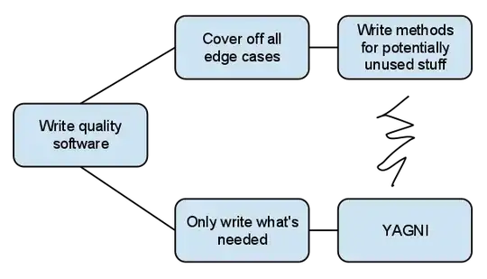

They aren't in conflict, your goals are wrong.
What are you attempting to accomplish?
You want to write quality software, and to do that you want to keep your code base small and not have issues.
Now we reach a conflict, how do we cover off all cases if we don't write cases we aren't going to use?
Here's what your problem looks like.
enter image description here (anyone interested, this is called evaporating clouds)
So, what's driving this?
  1. You don't know what you're not going to need
  2. You don't want to waste time and bloat your code
Which one of these can we solve? Well, it looks like not wanting to waste time and bloat code is a great goal, and makes sense. What about that first one? Can we find out what we're going to need to code?
