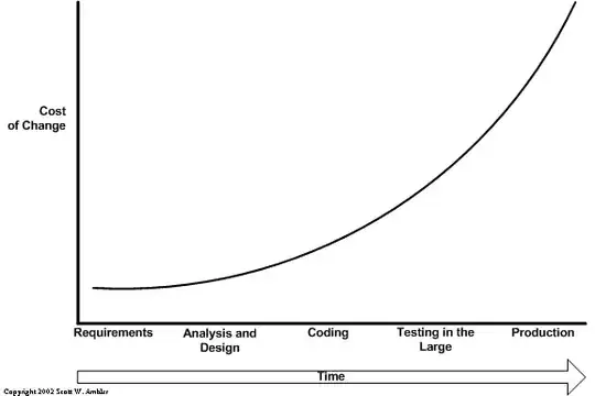

And why do we first design, then implement, even if many things change? Please see the following picture (source: http://www.agilemodeling.com/essays/costOfChange.htm) that clarifies this the best (at least I think so):

The intention of a software design is to fail cheap and fail early. When designing your implementation, you're forced to think things through early. It's always cheaper to find out you've made a mistake in a design phase than to realize that 80% of the work that you've done without a design has to be re-factored due to a design flaw.
Others with more experience than you will also have a chance to review your design prior to you spending time implementing your solution and point out any high level errors in your system.
It also gives those who step into your shoes in the future the ability to read something documented rather than try to figure out your code.
Of course, depending on the granularity of your design, some things may change, but the overall architecture stays the same roughly 90% of the time (with enough experience).
