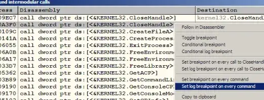

In OllyDbg search for all Intermodular calls. This would bring up a list of functions called from the main module. You can the set a logging breakpoint on all the functions. The disadvantage of this approach is that dynamically resolved function calls cannot not be intercepted.
