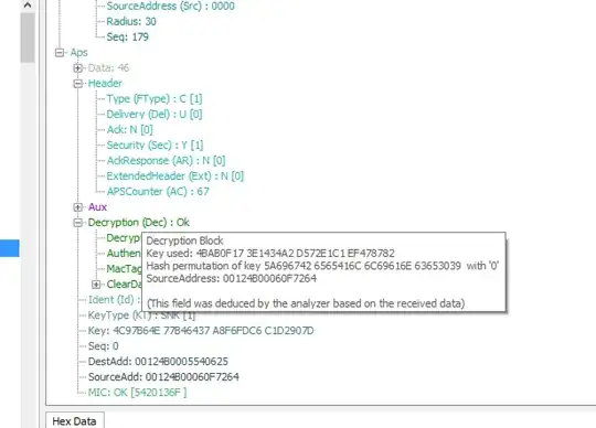

However, in the APS_CMD_KEY_TRANSPORT message sent to exchange the key, Perytons is showing that the APS layer data is in fact encrypted already, using a key that I have not seen before (4BAB0F173E1434A2D572E1C1EF478782)
The key for many Zigbee devices is "ZigBeeAlliance09", which is the case here for some communications, but this is not the key being used for key exchange.
Once the capture is complete, the Perytons "Keys Management" window shows the "ZigBeeAlliance09" key along with the one sent in the APS_CMD_KEY_TRANSPORT, but not the one used to decrypt the APS data.

Showing the encryption and key on the APS data

The key used is simply a hash of ZigBeeAlliance09. You see it in your picture pretty clear.
ZigBee uses the the default key as basis for different hash permutation of "ZigBeeAlliance09". Look it up in the ZigBee specification.
