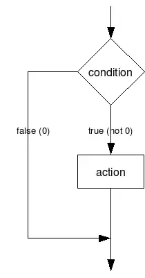

    Olly will show you machine language, and conditions (if) will translate to jump operands (je, jz, jne, ...).
    if secretKey123# not eq to your input
    (the action in this case would be enabling the button and showing a message)
  4. So now you know all these, it is time to look round. Run the app, attach Olly, or you can start your app from olly, and set it to break on the main function. This can be handy, because from there you can step by step follow the execution flow of the application. You now know what functions to look for. Put some breakpoints and observe. List all strings in the binary. See if any looks like a hardcoded password.
    If you find the piece of code that decides if your input is right or not, you could patch it, or just simply find the hardcoded password and enter it without modifying (patching) the binary.
