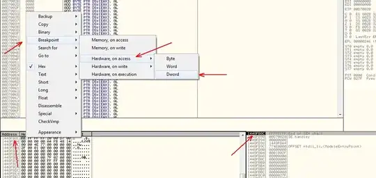

If the arguments of the function on stack is a pointer (such as pThreadId for CreateThread), then follow the steps below. Otherwise if the argument is some value (like CreationFlags) then refer to AcidShout's answer.
1. Right click on the address on the stack -> Chose Follow in Dump. enter image description here
2. In the dump window, right click on the value -> Breakpoint -> Hardware on access -> Byte / Word / Dword
