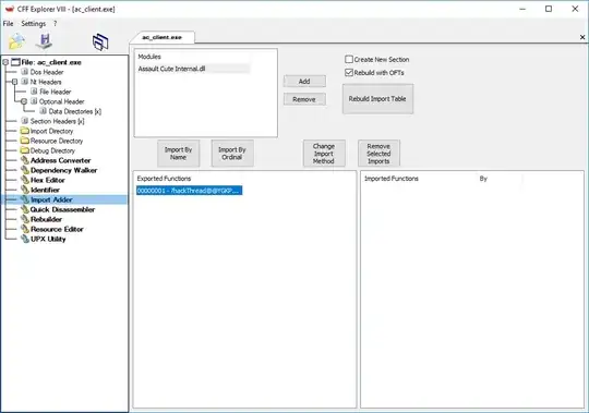

Another program which can do what you're looking for is CFF Explorer: enter image description here
