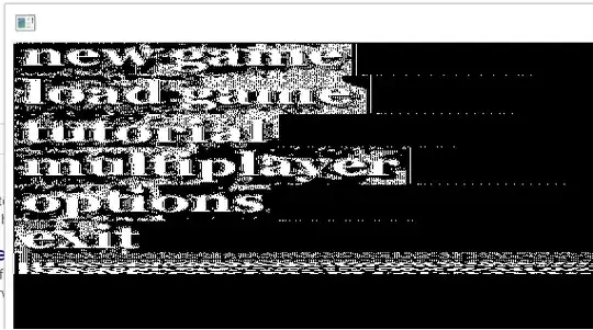

I'm trying to reverse engineer a file that contains sprites. I want to extract the sprites out of the file. So far I've managed to find some kind of line end sequence, and with this I've been able to confirm that the sprites are in the file:
monochrome dump of file
I'm using C++ and SDL. I load the file as a series of chars, and then plot a white pixel if the char>128 and a black if the char<128. It's very crude and I don't know how to proceed. How do I find where color is stored? Or an alpha channel? Or what is in the header? Etc.

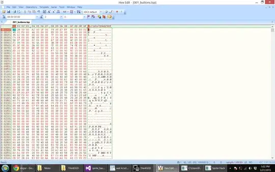

If you know of any online resources that could be helpfull, please let me know. I'm kind of lost at where to start. These are first couple of bytes from the file I'm trying to reverse engineer, maybe this will help:
hex dump of file

You got started well; plotting unknown data as pixels immediately showed you this is indeed graphic data, not compressed (at least the buttons aren't), and in a usable RGB order. I guess the missing RGB format was what held you back; now you know it, you can write a simple program to plot in color and show offsets and widths of the images. Armed with that information, you can inspect the unknown bytes before (and possibly after) the images, and derive their meaning.
General overview
The file 001_buttons.tsp consists of a series of images, without a general file header but with a header per image.
The first long word of this header (4 bytes, little endian format) is the size of the following data in bytes, excluding the header itself (this length may be 0). Then follow width and height as words. The next 12 bytes are 3 word-sized x,y pairs; the first pair is the center of the image. The coordinates are signed words, they wrap around at 0xFFFF/2. The other pairs still serve an unknown purpose.
After that, you have (height) times the offset of the next image scan line in words, offset from the start by 4 (so 4+2*offset = next line).
Each scan line pointed to by these offsets is Run-Length Encoded (RLE) compressed. Transparent runs are indicated only by the number of horizontal pixels to skip; opaque runs can be copied directly to the screen. There is no alpha transparency in these images. Each scan line fills exactly width pixels after decompressing.
The pixel format is packed 16-bit RGB: RRRR.RGGG.GGGB.BBBB, which can be converted to 24-bit RGB in the following (not optimized) way:
putpixel (x,y, (((val >> 8) & 0xf8)<<16) | (((val >> 3) & 0xfc)<<8) | ((val & 0x1f)<<3) );
where val is simply the next word: data[c]+(data[c+1]<<8).
