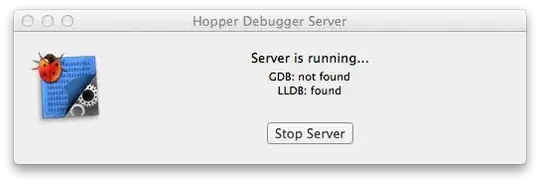

Hopper offers a GDB/LLDB Debugger Server companion to the standard program. I'm unclear on what this should / can be used for. When I run the debugger server on the same machine that I'm using I see this:
There aren't really any options or built-in help. When I open Hopper.app's debugger panel I only see the program running locally. I was initially thinking that the Remote Debugger was maybe used to offload some of the processing to another computer, but I've also tried running Hopper Debugger Server on another mac on my LAN but I don't see it come up in the list, only my local machine:
As there are no settings to specify remote connection information, I think I need to do something remotely that would specify a the address of the machine running Hopper so that it can sort of 'dial in' and then show up on the list.

  • Write a short program that crashes. You will see OSX'es own "Program terminated" dialog pop up, with the option to view the crash log and Send To Apple. What happens when when you have the debugger server running? – Jongware Jan 25 '15 at 16:41
  • @Jongware - you're saying it should catch OS X crashes and allow debugging? Does it do anything else, i.e. what about the "GDB: not found" message? – cwd Jan 25 '15 at 16:49
  • Well it's only a guess. It seems to search for a debugger to start up when a crash happens. – Jongware Jan 25 '15 at 16:52
  • On the same machine you don't need the debugger server anymore. There is a built-in debugger. Just for a remote machine. – Henno Brandsma Jan 25 '15 at 19:09
  • @HennoBrandsma - thanks, can you describe how to use it with a remote machine? Does the remote machine have to be a mac? – cwd Jan 26 '15 at 00:38
  • It's used to do remote debugging accross the network, so you don't have to run the debugger locally if for some reason it's a problem for you – toasted_flakes Apr 19 '15 at 14:13
