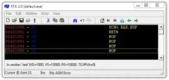

RTA is an easy to use tool that allows you to enter either opcodes or mnemonics and will convert them from one to the other.
In the example below, I entered XCHG EAX,ESP and RETN on the right, and RTA produced 94 and C3 on the left:
RTA
