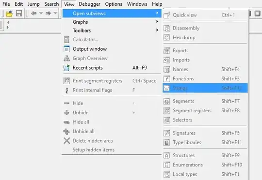

Initially, you could simply search for any strings which are printed in the dialog box, and the code which is executed after user input should be easy to locate thereafter, providing no obfuscation has been employed. For example, in IDA Pro:
If it's a simple password crackme, you should be looking for code which iterates through each character of a string, i.e. the user input, and compares it to some hardcoded value. Alternatively, as others have elaborated, you could look for specific uses of the Win32 API and find cross-references.

    The problem with this approach is, if it's a windows dialog, it'll be defined in some resource in the exe file, not in code/data, and you won't find the strings anywhere in IDA. – Guntram Blohm Jul 31 '14 at 17:43
  • Although you can load rsrc segment in IDA if I remember right? – Dominik Antal Aug 07 '14 at 15:14
    @DominikAntal: Yes, before the auto-analysis, IDA provides a 'load resource segment' checkbox option. – JamalS Aug 07 '14 at 15:14
