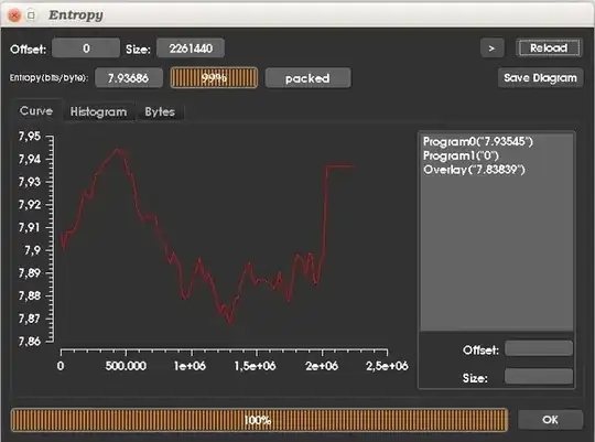

asdf
  • 156
Detect It Easy can do it:
Entropy
There is version for Linux.
