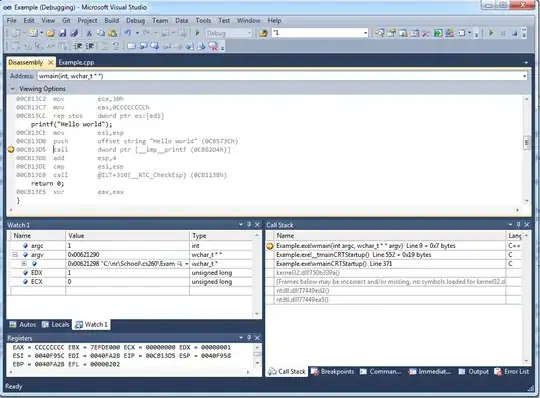

Which compiler are you using? My background is more in Windows development (as opposed to Linux/BSD/OSX), so I can only speak to that case.
But in Visual Studio, you can see the generated assembly while debugging C/C++. See this MSDN article for detail.
If you are only interested in the ASM, you may want to change some of the compilation settings within your Visual Studio project so that it reduces debug information included with the project. Detail on how to do that is here.
Primarily involves:
  • Disabling C++ exceptions
  • Debug information format set to Program Database (/Zi)
  • Turning off buffer security check (/GS-)
  • Turn off incremental linking (/NCREMENTAL:NO)
Embarcadero C++ Builder and Delphi (formerly Borland) offer the same functionality as well. Usage detail here. enter image description here
