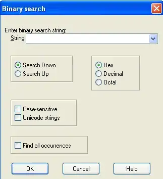

Since IDA can search for bytes, all you have to do is open the new binary in IDA and "search for sequence of bytes", paste your byte pattern, and if your pattern is valid and you are lucky, you'll have a few results, one of them will be the teleport function most likely.

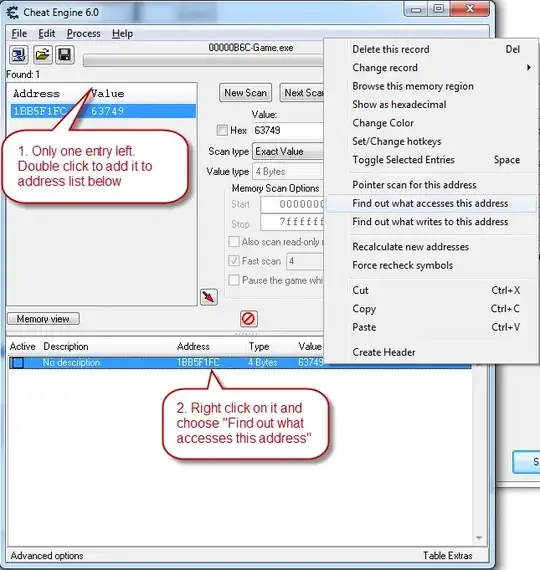

The other way I'd try it is this: You said you have the address + offset combination to the coordinates. Add that memory location in Cheat Engine, and observe where it gets accessed in cheat engine, and hope that there is nothing quirky behind the scenes, you should get a list of places that reads/writes your coordinates, one of them will be probably your teleport function you're after.
