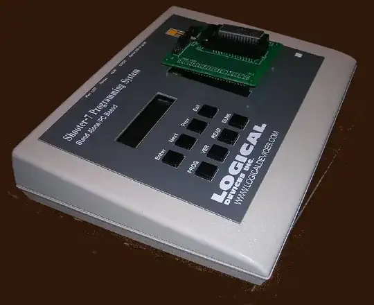

Extracting the content of a hardware chip is known as "snarf"ing. (That term may help with your Google searches.)
To snarf the contents of a chip, you need a ROM reader/programmer, such as one of the devices from http://www.needhams.com/programmers.htm
ROM programmer
