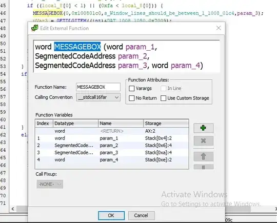

A Typical listing in ghidra of USER!MESSAGEBOX in a 16 Bit NE Exe post analysis
   LAB_1000_07f0                        XREF[2]:     1000:0770(j), 1000:0775(j)
   1000:07f0 ff 76 0e               PUSH       word ptr [BP + param_3]
   1000:07f3 1e                     PUSH       DS
   1000:07f4 68 c4 01               PUSH       0x1c4
   1000:07f7 1e                     PUSH       DS
   1000:07f8 68 c0 01               PUSH       0x1c0
   1000:07fb 6a 00                  PUSH       0x0
   1000:07fd 9a 9c 00 50 10         CALLF      USER::MESSAGEBOX     undefined MESSAGEBOX()
and its decompilation
uVar7 = param_3;
MESSAGEBOX((int)&DAT_1008_1050,0,0x1c0,(int)s_run-time_error_1008_1001 + 7,0x1c4,
           (int)s_run-time_error_1008_1001 + 7);
as you can see the MESSAGEBOX is undefined()
Right click on the MESSAGEBOX (in decompiled window or in listing) and edit the function signature as shown in screen shot and see the Decompiled output
that is far better but it still misses the Caption String
double click the 32bit addres 100801c0
you will see this an undefined ascii string (probably coz ghidra default str length is > 3)
   1008:01c0 53                     ??         53h    S
   1008:01c1 50                     ??         50h    P
   1008:01c2 59                     ??         59h    Y
   1008:01c3 00                     ??         00h
define it as a string using right click -> Data ->Terminatedcstring
to make the listing
   1008:01c0 53 50 59 00            ds         "SPY"
and the decompilation will be
  if ((local_8[0] < 1) || (0xfa < local_8[0])) {
    MESSAGEBOX(0,s_SPY_1008_01c0,s_Window_lines_should_be_between_1_1008_01c4,param_3);

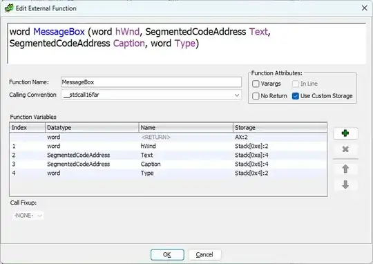

As per the comment made by @blabb on his answer, I looked at the Win16 WINDOWS.H header file (from the Windows 3.1 Driver Development Kit (DDK)) to see which calling conventions were used for the Win16 API functions at the time.
At the beginning of the file, the following macro is defined:
#define WINAPI _far _pascal
This macro is then appended to the beginning of most of the functions in the file, for example:
int WINAPI MessageBox(HWND, LPCSTR, LPCSTR, UINT);
UINT WINAPI GetPrivateProfileInt(LPCSTR, LPCSTR, int, LPCSTR);
LPSTR WINAPI lstrcpy(LPSTR, LPCSTR);
So it seems as though most of the Win16 API functions were defined with the Pascal calling convention, which explains why I can see the parameters being PUSHed backwards onto the stack before the CALL instruction is utilised.
So by implementing the function this way:
Ghidra implementation of the WIN16 MessageBox function with the Pascal calling convention.
The parameters are pulled in correctly and the decompilation is accurate.
Ghidra decompilation of the WIN16 MessageBox function using the Pascal calling convention.
Currently, I'm having to setup the parameter storage manually as Ghidra does not support the Pascal calling convention, an issue on GitHub has been opened here: https://github.com/NationalSecurityAgency/ghidra/issues/496
